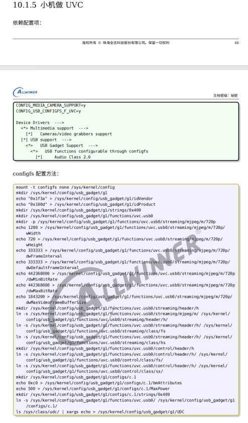

      • 1,系统默认otg-usb是ADB devce,在内核和tina linux上关闭了adb相关,otg-usb给Gadget uvc;
      • 2,参考如下官方资料
      • 3,将官方命令整合成如下脚本uvc.sh
      #!/bin/sh
      mount -t configfs none /sys/kernel/config
      mkdir /sys/kernel/config/usb_gadget/g1
      echo "0x1f3a" > /sys/kernel/config/usb_gadget/g1/idVendor
      echo "0x100d" > /sys/kernel/config/usb_gadget/g1/idProduct
      #添加设备字符串
      mkdir /sys/kernel/config/usb_gadget/g1/strings/0x409
      echo "Tina"         > /sys/kernel/config/usb_gadget/g1/strings/0x409/manufacturer
      echo "UVC Cam"      > /sys/kernel/config/usb_gadget/g1/strings/0x409/product
      echo "0123456789"   > /sys/kernel/config/usb_gadget/g1/strings/0x409/serialnumber
      #添加 UVC function(最小化配置)
      mkdir -p /sys/kernel/config/usb_gadget/g1/functions/uvc.usb0
      #添加最简单的一组 MJPEG 配置(测试用)
      mkdir -p /sys/kernel/config/usb_gadget/g1/functions/uvc.usb0/streaming/mjpeg/m/720p
      echo 1280 > /sys/kernel/config/usb_gadget/g1/functions/uvc.usb0/streaming/mjpeg/m/720p/wWidth
      echo 720 > /sys/kernel/config/usb_gadget/g1/functions/uvc.usb0/streaming/mjpeg/m/720p/wHeight
      echo 333333 > /sys/kernel/config/usb_gadget/g1/functions/uvc.usb0/streaming/mjpeg/m/720p/dwFrameInterval
      echo 333333 > /sys/kernel/config/usb_gadget/g1/functions/uvc.usb0/streaming/mjpeg/m/720p/dwDefaultFrameInterval
      echo 442368000 > /sys/kernel/config/usb_gadget/g1/functions/uvc.usb0/streaming/mjpeg/m/720p/dwMinBitRate
      echo 442368000 > /sys/kernel/config/usb_gadget/g1/functions/uvc.usb0/streaming/mjpeg/m/720p/dwMaxBitRate
      echo 1843200 > /sys/kernel/config/usb_gadget/g1/functions/uvc.usb0/streaming/mjpeg/m/720p/dwMaxVideoFrameBufferSize
      mkdir /sys/kernel/config/usb_gadget/g1/functions/uvc.usb0/streaming/header/h
      ln -s /sys/kernel/config/usb_gadget/g1/functions/uvc.usb0/streaming/mjpeg/m/ /sys/kernel/config/usb_gadget/g1/functions/uvc.usb0/streaming/header/h/
      ln -s /sys/kernel/config/usb_gadget/g1/functions/uvc.usb0/streaming/header/h/ /sys/kernel/config/usb_gadget/g1/functions/uvc.usb0/streaming/class/fs
      ln -s /sys/kernel/config/usb_gadget/g1/functions/uvc.usb0/streaming/header/h/ /sys/kernel/config/usb_gadget/g1/functions/uvc.usb0/streaming/class/hs
      mkdir /sys/kernel/config/usb_gadget/g1/functions/uvc.usb0/control/header/h
      ln -s /sys/kernel/config/usb_gadget/g1/functions/uvc.usb0/control/header/h/ /sys/kernel/config/usb_gadget/g1/functions/uvc.usb0/control/class/fs/
      ln -s /sys/kernel/config/usb_gadget/g1/functions/uvc.usb0/control/header/h/ /sys/kernel/config/usb_gadget/g1/functions/uvc.usb0/control/class/ss/
      mkdir /sys/kernel/config/usb_gadget/g1/configs/c.1
      echo 0xc0 > /sys/kernel/config/usb_gadget/g1/configs/c.1/bmAttributes
      echo 500 > /sys/kernel/config/usb_gadget/g1/configs/c.1/MaxPower
      mkdir /sys/kernel/config/usb_gadget/g1/configs/c.1/strings/0x409
      echo "UVC Config" > /sys/kernel/config/usb_gadget/g1/configs/c.1/strings/0x409/configuration
      ln -s /sys/kernel/config/usb_gadget/g1/functions/uvc.usb0/ /sys/kernel/config/usb_gadget/g1/configs/c.1/
      ls /sys/class/udc/ | xargs echo > /sys/kernel/config/usb_gadget/g1/UDC
