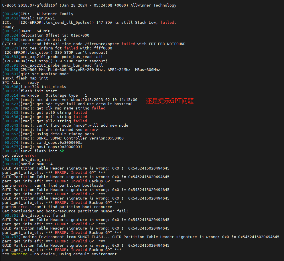

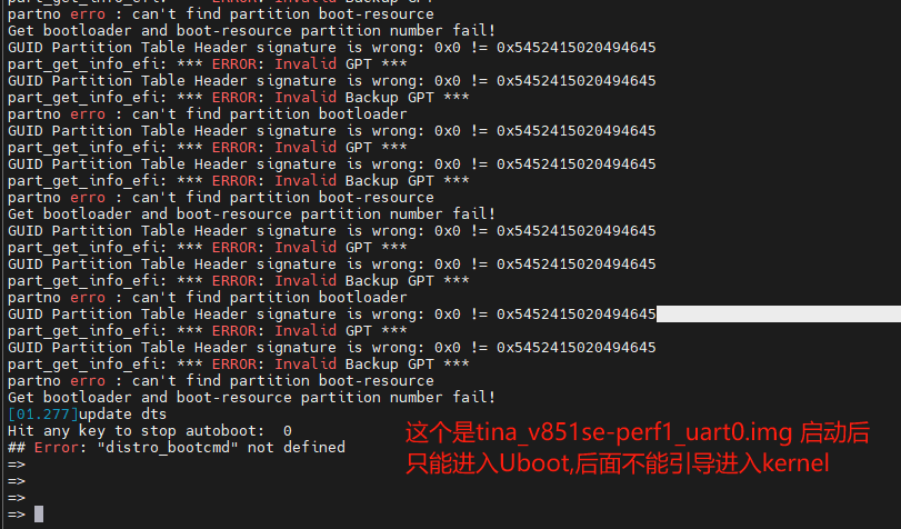

    • V851SE SD Card启动镜像编译,启动到uboot后,报GUID Partition Table Header signature is wrong: 0x0 != 0x5452415020494645
      xxxx@rz-server:~/v85x$ source build/envsetup.sh
      Setup env done! Please run lunch next.
      xxxx@rz-server:~/v85x$ lunch
      You're building on Linux
      Lunch menu... pick a combo:
      1. v553_perf1-tina
      2. v553_qa-tina
      3. v837s_ipc-tina
      4. v837s_perf1-tina
      5. v851s3_four_camera-tina
      6. v851s3_perf1-tina
      7. v851se_perf1-tina
      8. v851s_ipc_dual_camera-tina
      9. v851s_perf1-tina
      10. v853_perf1-tina
      11. v853_perf2-tina
      12. v853s_perf1-tina
      13. v853s_perf2-tina
      14. v853_vision-tina
      Which would you like? [Default v851se_perf1]: 7
      TINA_BUILD_TOP=/home/xxxx/v85x
      TINA_TARGET_ARCH=arm
      TARGET_PRODUCT=v851se_perf1
      TARGET_PLATFORM=v851se
      TARGET_BOARD=v851se-perf1
      TARGET_PLAN=perf1
      TARGET_BUILD_VARIANT=tina
      TARGET_BUILD_TYPE=release
      TARGET_KERNEL_VERSION=4.9
      TARGET_UBOOT=u-boot-2018
      TARGET_CHIP=sun8iw21p1
      硬件sd卡接口:sdc0
      设备树使能sdc0:board.dts, uboot-board.dts 确认没有问题
      系统设置文件:sys_config.fex 确认 storage_type = 1
      系统分区文件:使用的是 sys_partition.fex 用于NAND,EMMC,SDCard的
      镜像配置文件:使用device/config/chips/v851se/configs/default/image.cfg , 其中添加 {filename = "sunxi_gpt.fex", maintype = "12345678", subtype = "1234567890___GPT",},
      编译完成,pack打包后生成文件:tina_v851se-perf1_uart0.img
      使用gdisk 工具查看文件分区
      xxxx@rz-server:~/v85x/out/v851se-perf1$ gdisk tina_v851se-perf1_uart0.img
      GPT fdisk (gdisk) version 1.0.8
      Partition table scan:
      MBR: not present
      BSD: not present
      APM: not present
      GPT: not present
      posted in V Series
