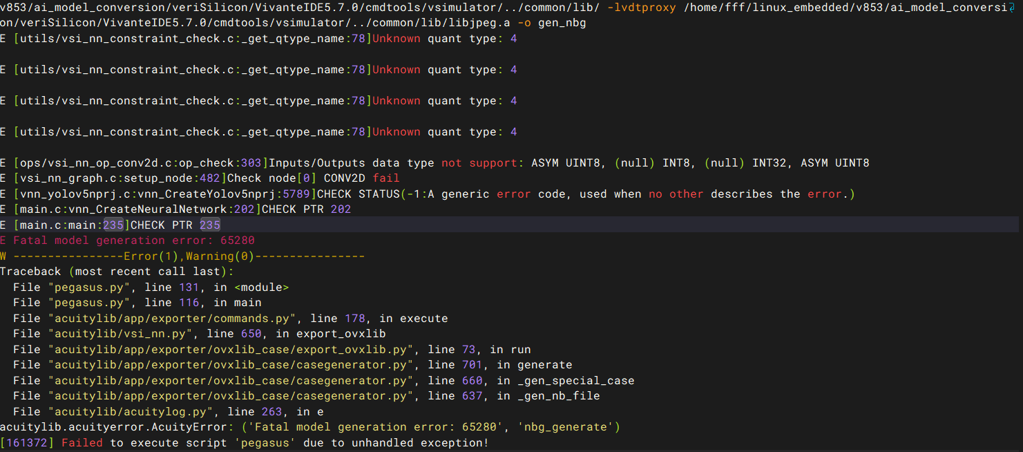

              一些没提到坑点:
              当环境没配好会报:
              Traceback (most recent call last):
              File "pegasus.py", line 131, in <module>
              File "pegasus.py", line 112, in main
              File "acuitylib/app/importer/commands.py", line 248, in execute
              File "acuitylib/vsi_nn.py", line 125, in load_onnx
              File "acuitylib/app/importer/import_onnx.py", line 38, in run
              File "acuitylib/app/importer/import_onnx.py", line 33, in import_onnx_ruler_module
              ModuleNotFoundError: No module named 'onnxruler'
              解决办法
              ACUITY_TOOLS_METHOD=acuity-toolkit-binary-6.6.1
              export ACUITY_PATH=/opt/ye/VeriSilicon/$ACUITY_TOOLS_METHOD/bin/
              export VIV_SDK=/opt/ye/VeriSilicon/VivanteIDE5.7.0/cmdtools/
              export PATH=$PATH:/opt/ye/VeriSilicon/$ACUITY_TOOLS_METHOD/bin/:/opt/ye/VeriSilicon/VivanteIDE5.7.0/ide/
              export pegasus=/opt/ye/VeriSilicon/$ACUITY_TOOLS_METHOD/bin/pegasus
              alias pegasus=/opt/ye/VeriSilicon/$ACUITY_TOOLS_METHOD/bin/pegasus
              参考: 全志V853 NPU 体验
              坑2: 存在无法转换的节点?
              File "acuitylib/app/importer/import_onnx.py", line 117, in run
              File "acuitylib/converter/onnx/convert_onnx.py", line 66, in init
              File "acuitylib/converter/onnx/convert_onnx.py", line 114, in __shape_inference
              File "acuitylib/onnx_ir/onnx_numpy_backend/shape_inference.py", line 65, in infer_shape
              File "acuitylib/onnx_ir/onnx_numpy_backend/smart_graph_engine.py", line 70, in smart_onnx_scanner
              File "acuitylib/onnx_ir/onnx_numpy_backend/smart_node.py", line 48, in calc_and_assign_smart_info
              File "acuitylib/onnx_ir/onnx_numpy_backend/smart_toolkit.py", line 653, in multi_direction_broadcast_shape
              File "acuitylib/onnx_ir/onnx_numpy_backend/smart_toolkit.py", line 640, in _braodcast_shape
              ValueError: operands could not be broadcast together with shapes (1,3,40,40,0) (1,3,40,40,2)
              [3572303] Failed to execute script 'pegasus' due to unhandled exception!
              解决
              猜测系想yolov5的版本太新, 对齐到 tag: v6.0
              坑:目录没权限
              File "acuitylib/converter/onnx/convert_onnx.py", line 74, in init
              File "acuitylib/converter/onnx/convert_onnx.py", line 118, in __build_ruler_db
              File "acuitylib/converter/ruler_tool.py", line 50, in setup_db
              FileNotFoundError: [Errno 2] No such file or directory: '/opt/ye/VeriSilicon/acuity-toolkit-binary-6.6.1/bin/onnx_ruler_db.json'

              • C
                cedarf LV 4 @aldfaaa 最后由 编辑
                @aldfaaa 您好,借楼问一下,请问您遇到过对称int8量化无法导出nb文件的问题吗,用的是100ask_v853-AICT,其他量化方式可以正常导出。
