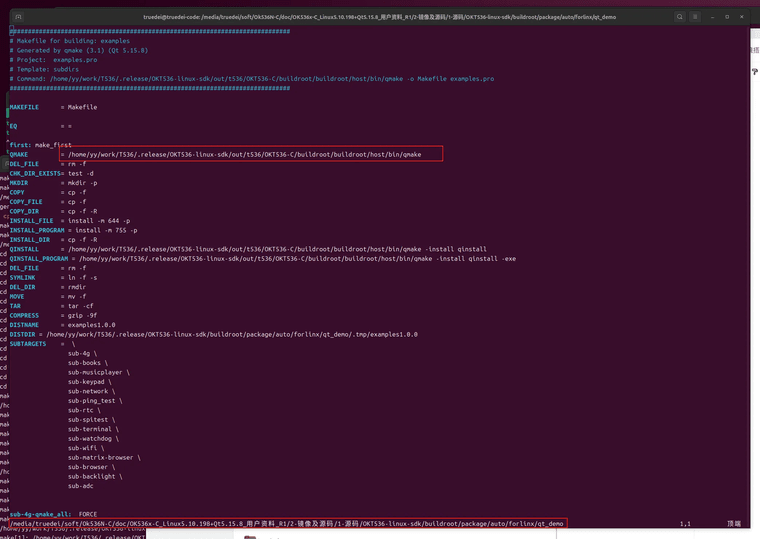

      我还发现了一个问题,在编译qt_demo时,Makefile中的qmake路径是写死的:
      cd browser/ && ( test -e Makefile || /media/truedei/soft/Ok536N-C/OKT536-linux-sdk/out/t536/OKT536-C/buildroot/buildroot/host/bin/qmake -o Makefile /media/truedei/soft/Ok536N-C/OKT536-linux-sdk/buildroot/package/auto/forlinx/qt_demo/browser/browser.pro ) && make -f Makefile
      cd backlight/ && ( test -e Makefile || /media/truedei/soft/Ok536N-C/OKT536-linux-sdk/out/t536/OKT536-C/buildroot/buildroot/host/bin/qmake -o Makefile /media/truedei/soft/Ok536N-C/OKT536-linux-sdk/buildroot/package/auto/forlinx/qt_demo/backlight/backlight.pro ) && make -f Makefile
      cd adc/ && ( test -e Makefile || /media/truedei/soft/Ok536N-C/OKT536-linux-sdk/out/t536/OKT536-C/buildroot/buildroot/host/bin/qmake -o Makefile /media/truedei/soft/Ok536N-C/OKT536-linux-sdk/buildroot/package/auto/forlinx/qt_demo/adc/adc.pro ) && make -f Makefile
      make[1]: Entering directory '/media/truedei/soft/Ok536N-C/OKT536-linux-sdk/buildroot/package/auto/forlinx/qt_demo/musicplayer'
      /home/yy/work/T536/.release/OKT536-linux-sdk/out/t536/OKT536-C/buildroot/buildroot/host/bin/qmake -o Makefile musicplayer.pro
      make[1]: /home/yy/work/T536/.release/OKT536-linux-sdk/out/t536/OKT536-C/buildroot/buildroot/host/bin/qmake: No such file or directory
      make[1]: *** [Makefile:282: Makefile] Error 127
      make[1]: Leaving directory '/media/truedei/soft/Ok536N-C/OKT536-linux-sdk/buildroot/package/auto/forlinx/qt_demo/musicplayer'
      make: *** [Makefile:111: sub-musicplayer-make_first] Error 2
      make: *** Waiting for unfinished jobs....
      make[1]: Entering directory '/media/truedei/soft/Ok536N-C/OKT536-linux-sdk/buildroot/package/auto/forlinx/qt_demo/watchdog'
      /home/yy/work/T536/.release/OKT536-linux-sdk/out/t536/OKT536-C/buildroot/buildroot/host/bin/qmake -o Makefile watchdog.pro
      make[1]: *** [Makefile:276: Makefile] Error 127
      报错的路径:
      正确的路径:
      导致该问题的原因:
      现在我在刚解压过的原始sdk中,没做过任何编译:
      truedei@truedei-code:qt_demo$ pwd
      /media/truedei/soft/Ok536N-C/doc/OK536x-C_Linux5.10.198+Qt5.15.8_用户资料_R1/2-镜像及源码/1-源码/OKT536-linux-sdk/buildroot/package/auto/forlinx/qt_demo

      随便打开一个Makefile看下心里就有数了:
      排查的最终解决方案:
      清理掉qt_demo的所有Makefile和.qmake.stash。

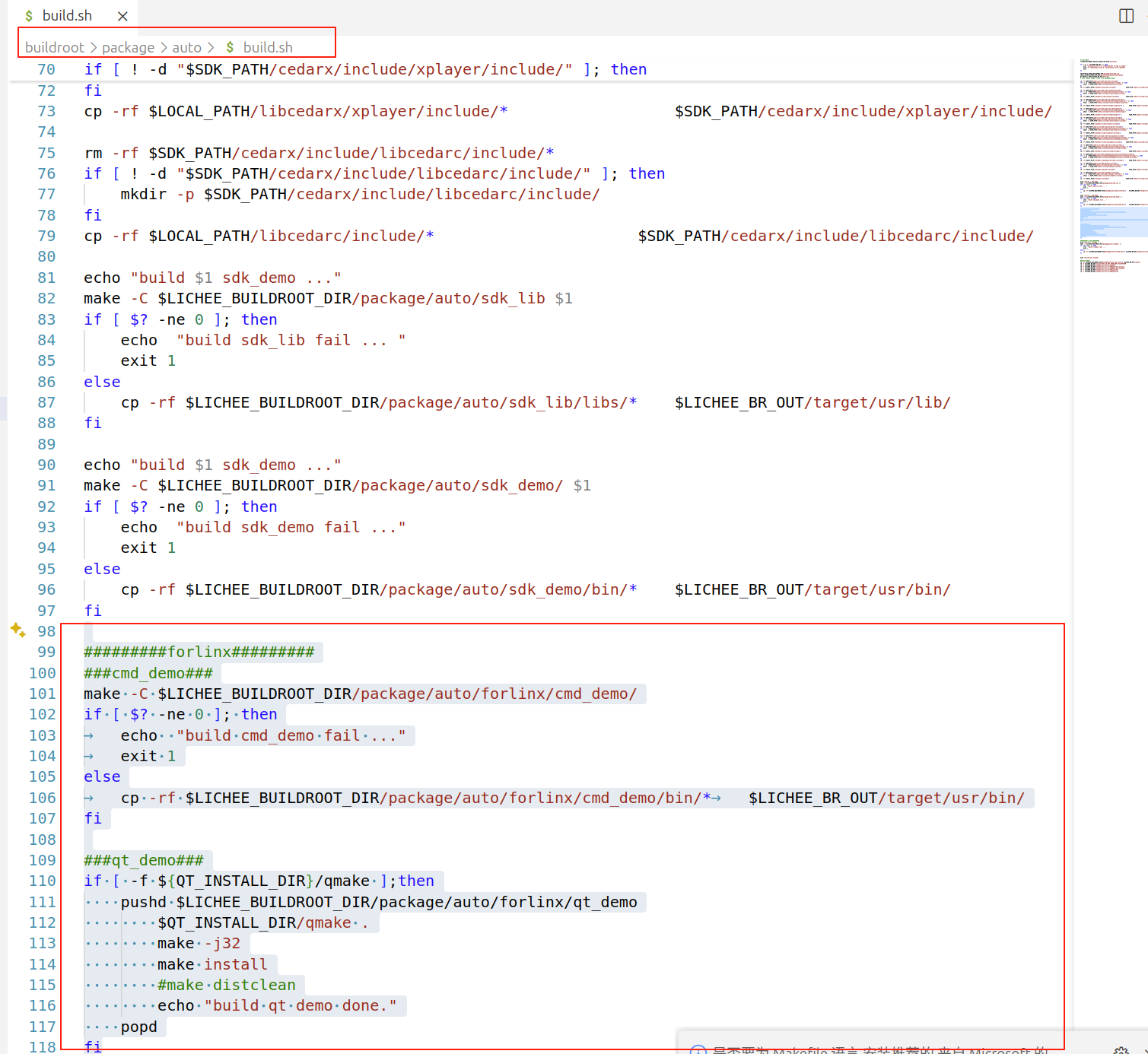

      可以打开OKT536-linux-sdk/buildroot/package/auto/build.sh研究下:
      看得出来,这各forlinx就是飞凌新增的脚本片段。

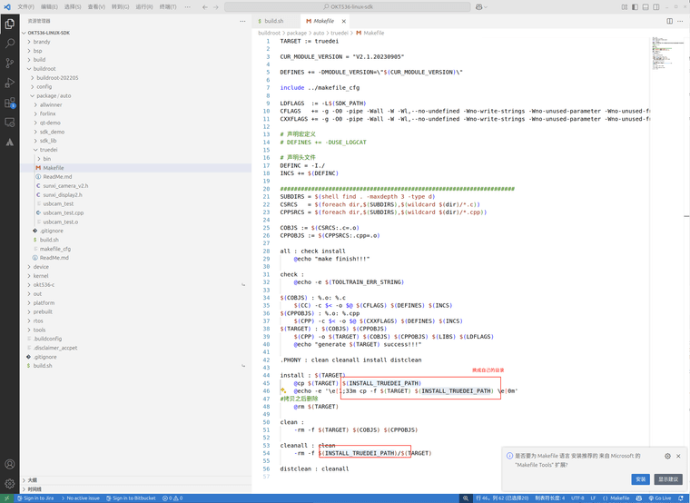

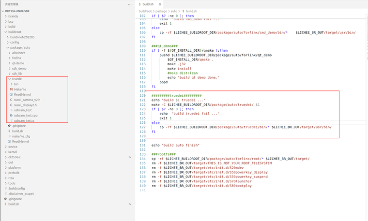

      我们可以把OKT536-linux-sdk/buildroot/package/auto目录当项目根目录,继续创建目录
      我完全是把OKT536-linux-sdk/buildroot/package/auto/sdk_demo/usbcam_test拷贝过来了,改了个名字
      build.sh脚本新增:
      #########truedei#########
      echo "build $1 truedei ..."
      make -C $LICHEE_BUILDROOT_DIR/package/auto/truedei/ $1
      if [ $? -ne 0 ]; then
      	echo  "build truedei fail ..."
      	exit 1
      else
      	cp -rf $LICHEE_BUILDROOT_DIR/package/auto/truedei/bin/*	$LICHEE_BR_OUT/target/usr/bin/
      fi
      Makefile需要修改下:

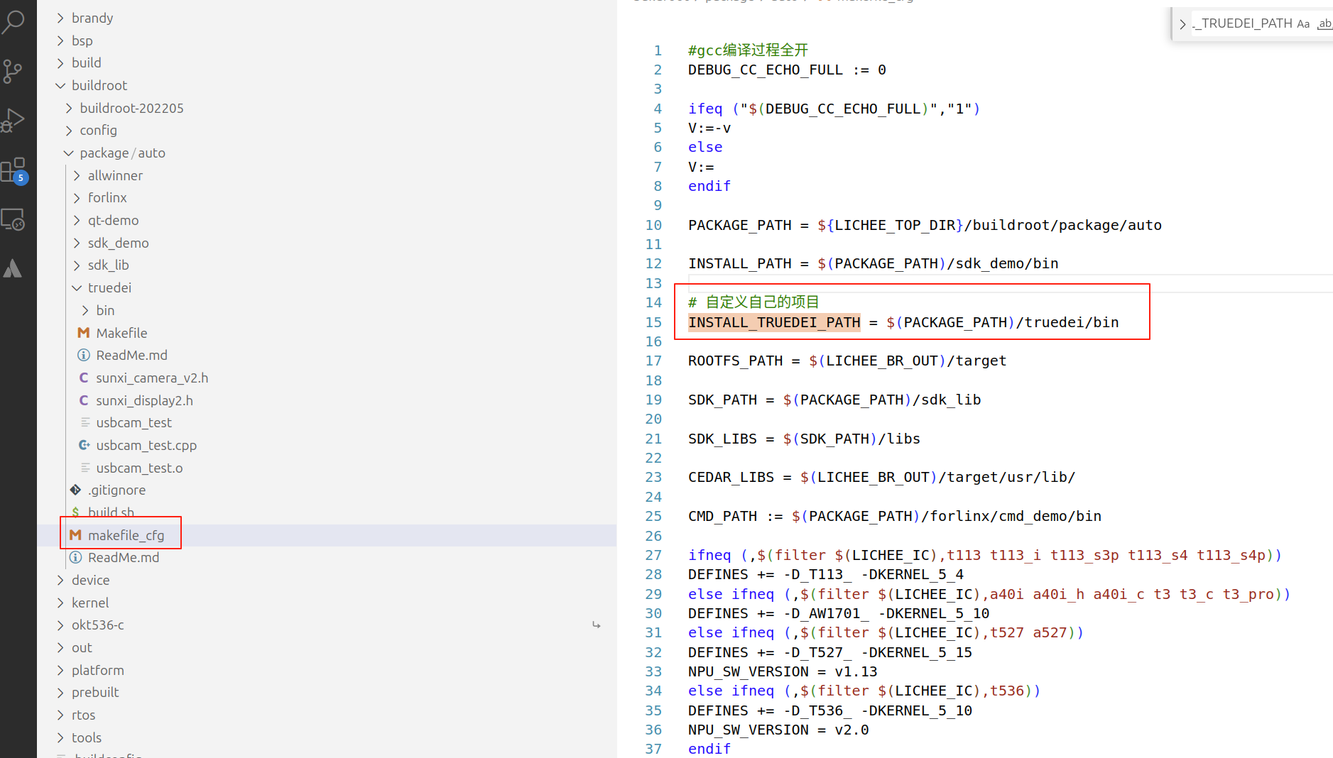

      INSTALL_TRUEDEI_PATH变量是在auto目录下的makefile_cfg中定义的:
      # 自定义自己的项目
      INSTALL_TRUEDEI_PATH = $(PACKAGE_PATH)/truedei/bin
      然后就可以编译了,为了省时间,可以直接到项目中编译即可:
