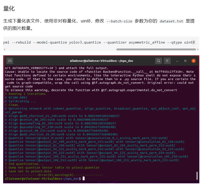

      这一步失败了,不明白为什么....
      命令:
      pegasus quantize --model yolov3.json --model-data yolov3.data --batch-size 2 --device CPU --with-input-meta yolov3_inputmeta.yml --rebuild --model-quantize yolov3.quantize --quantizer asymmetric_affine --qtype uint8
      结果:
      D Process convolution_64_147 ...
      D Acuity output shape(convolution): (2 76 76 18)
      D Tensor @convolution_64_147:out0 type: float32
      D Process output_65_148_acuity_mark_perm_152 ...
      D Acuity output shape(permute): (2 18 76 76)
      D Tensor @output_65_148_acuity_mark_perm_152:out0 type: float32
      D Process output_65_148 ...
      D Acuity output shape(output): (2 18 76 76)
      D Tensor @output_65_148:out0 type: float32
      I Build prune_16 complete.
      D *********** Setup database (1) ***********
      D Setup dataset "TEXT":
      D Lids: ['input_0']
      D Layouts: ['nchw']
      D Shapes: [[2, 3, 608, 608]]
      D Data types: ['float32']
      D Sparse tensors: []
      D Tensor names(H5FS only): []
      W:tensorflow:AutoGraph could not transform <acuitylib.core.execution.BackendFunction object at 0x7f8c8c056d90> and will run it as-is.
      Please report this to the TensorFlow team. When filing the bug, set the verbosity to 10 (on Linux, `export AUTOGRAPH_VERBOSITY=10`) and attach the full output.
      Cause: Unable to locate the source code of <function BackendFunction.__call__ at 0x7f8c8cec69d0>. Note that functions defined in certain environments, like the interactive Python shell do not expose their source code. If that is the case, you should to define them in a .py source file. If you are certain the code is graph-compatible, wrap the call using @tf.autograph.do_not_convert. Original error: could not get source code
      To silence this warning, decorate the function with @tf.autograph.experimental.do_not_convert
      I Running 1 iterations
      D 0(100.00%)
      D Calibrating ...
      Traceback (most recent call last):
        File "pegasus.py", line 131, in <module>
        File "pegasus.py", line 108, in main
        File "acuitylib/app/medusa/commands.py", line 212, in execute
        File "acuitylib/vsi_nn.py", line 589, in quantize
        File "acuitylib/app/medusa/quantization.py", line 151, in run
        File "acuitylib/app/medusa/quantization.py", line 58, in _run_quantization
        File "acuitylib/quantization/quantize_manager.py", line 516, in calculate_params
        File "acuitylib/quantization/quantize_manager.py", line 272, in _cal_quantize_param_all
        File "acuitylib/quantization/types.py", line 200, in calibrate
        File "acuitylib/quantization/quantizers/asymmetric_quantizer.py", line 102, in convert_from_minmax
        File "acuitylib/quantization/quantizers/asymmetric_quantizer.py", line 161, in compute_from_minmax
        File "acuitylib/quantization/utils.py", line 230, in iscorrect_scalar_minmax_value
      ValueError: NAN is detected in minmax (nan,nan)
      [4296] Failed to execute script 'pegasus' due to unhandled exception!
