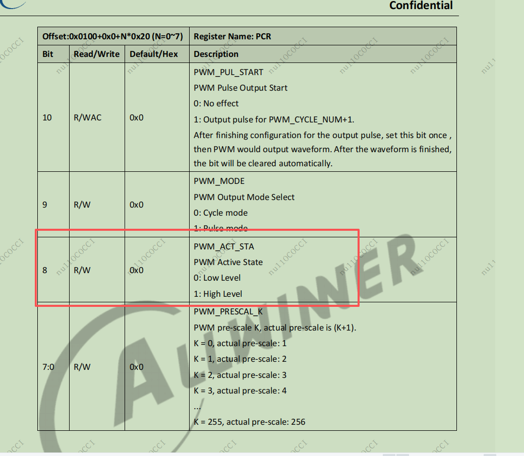

      各位大佬们好!
      刚刚再看pwm的部分,发现手册写的是默认是0,如下图
      但是在驱动中加了打印,为啥默认读出来的是1呢?
      代码路径:
      pwm-sunxi-group.c-->sunxi_pwm_probe-->pwmchip_add-->core.c-->pwmchip_add_with_polarity-->(chip->ops->get_state)-->sunxi_pwm_get_state
      代码如下:
      static void sunxi_pwm_get_state(struct pwm_chip *pwm_chip,
                   struct pwm_device *pwm_device,
                   struct pwm_state *state)
          unsigned int reg_offset;
          u32 val, sel;
          struct sunxi_pwm_chip *pc;
          pc = to_sunxi_pwm_chip(pwm_chip);
          sel = pwm_device->pwm - pwm_chip->base;
          reg_offset = pc->data->pcr_base_offset + sel * PWM_REG_UNIFORM_OFFSET;
          val = sunxi_pwm_readl(pwm_chip, reg_offset);
          if (val & BIT_MASK(8))
              state->polarity = PWM_POLARITY_NORMAL;
          else
              state->polarity = PWM_POLARITY_INVERSED;
          pr_err("polarity = %d\n", state->polarity);
      默认打印出来是1,是手册写错了吗?
