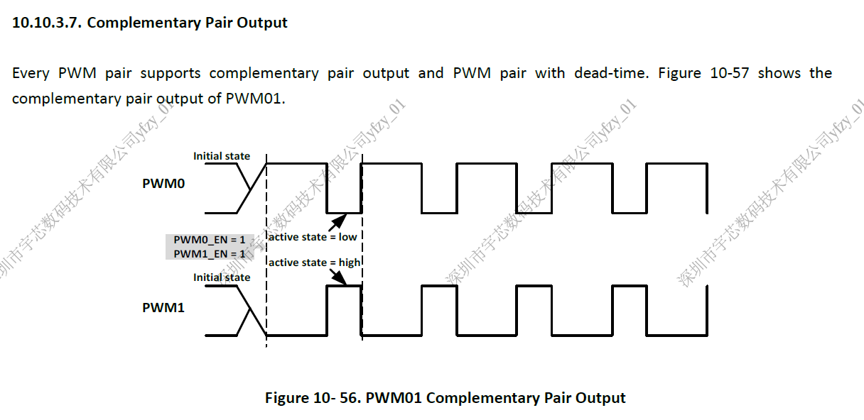

      需求:全志T507,把PI12、PI13复用为PWM2、PWM3,想要让PWM2、3互补输出。
      T507手册上支持pwm互补输出
      看源码需要在设备树里面配置"bind_pwm"和"dead_time",获取死区时间和“互补输出绑定的pwm??”,这里的bind_pwm不是很理解。

      但是按照源码里面增加“bind_pwm”和“dead_time”
      		pwm2: pwm2@0300a000 {
      			pinctrl-names = "active", "sleep";
      			pinctrl-0 = <&pwm2_pin_a>;
      			pinctrl-1 = <&pwm2_pin_b>;
      			bind_pwm = 2;
      			dead_time = 1000;
      			status = "okay";
      编译报错
      Error: arch/arm64/boot/dts/sunxi/CII-Common.dtsi:543.15-16 syntax error
      FATAL ERROR: Unable to parse input tree
      make[2]: *** [scripts/Makefile.lib:313: arch/arm64/boot/dts/sunxi/board.dtb] Error 1
      make[1]: *** [scripts/Makefile.build:648: arch/arm64/boot/dts/sunxi] Error 2
      make: *** [arch/arm64/Makefile:153: dtbs] Error 2
      make: *** Waiting for unfinished jobs....
        CHK     kernel/config_data.h
      ERROR: build kernel Failed
      INFO: mkkernel failed
      请问怎么配置才能让pwm互补输出?
