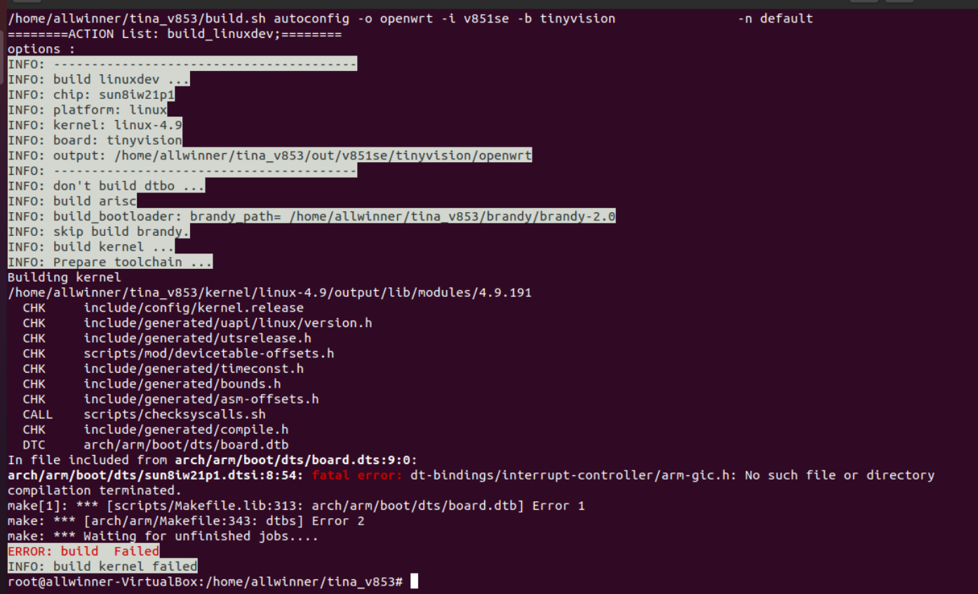

      log如下:
      root@allwinner-VirtualBox:/home/allwinner/tina_v853# source build/envsetup.sh
      NOTE: The SDK(/home/allwinner/tina_v853) was successfully loaded
      load openwrt... ok
      Please run lunch next for openwrt.
      load buildroot,bsp...ok
      Please run ./build.sh config next for buildroot,bsp.
      root@allwinner-VirtualBox:/home/allwinner/tina_v853# lunch
      You're building on Linux
      Lunch menu... pick a combo:
           1	v851se-tinyvision-tina
           2	v853-vision-tina
      Which would you like? [Default v851se-tinyvision]: 1
      Jump to longan autoconfig
      /home/allwinner/tina_v853/build.sh autoconfig -o openwrt -i v851se -b tinyvision 		-n default
      ========ACTION List: build_linuxdev;========
      options :
      INFO: ----------------------------------------
      INFO: build linuxdev ...
      INFO: chip: sun8iw21p1
      INFO: platform: linux
      INFO: kernel: linux-4.9
      INFO: board: tinyvision
      INFO: output: /home/allwinner/tina_v853/out/v851se/tinyvision/openwrt
      INFO: don't build dtbo ...
      INFO: build arisc
      INFO: build_bootloader: brandy_path= /home/allwinner/tina_v853/brandy/brandy-2.0
      INFO: skip build brandy.
      INFO: build kernel ...
      INFO: Prepare toolchain ...
      Building kernel
      /home/allwinner/tina_v853/kernel/linux-4.9/output/lib/modules/4.9.191
        CHK     include/config/kernel.release
        CHK     include/generated/uapi/linux/version.h
        CHK     scripts/mod/devicetable-offsets.h
        CHK     include/generated/utsrelease.h
        CHK     include/generated/timeconst.h
        CHK     include/generated/bounds.h
        CHK     include/generated/asm-offsets.h
        CALL    scripts/checksyscalls.sh
        CHK     include/generated/compile.h
        DTC     arch/arm/boot/dts/board.dtb
      In file included from arch/arm/boot/dts/board.dts:9:0:
      arch/arm/boot/dts/sun8iw21p1.dtsi:8:54: fatal error: dt-bindings/interrupt-controller/arm-gic.h: No such file or directory
      compilation terminated.
      make[1]: *** [scripts/Makefile.lib:313: arch/arm/boot/dts/board.dtb] Error 1
      make: *** [arch/arm/Makefile:343: dtbs] Error 2
      make: *** Waiting for unfinished jobs....
      ERROR: build  Failed
      INFO: build kernel failed

          感觉sdk不全,头文件都没找到

            @awwwwa SDK不是repo安装的 代码里是能找到这个.h的,但是不确定是不是需要设定环境变量还是什么相关的内容 引用文件里就是显示找不到
