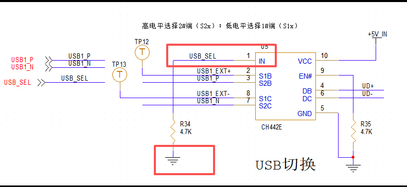

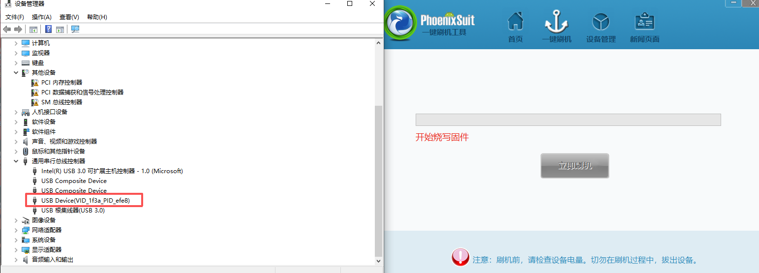

    自己画的板子,用了T113-S3,镜像也编译了,但是卡在烧录界面不动,求大佬帮助
    6
    9
    7832
    • P
      planA8 LV 2 最后由 编辑
      驱动装好了,电脑也可以识别设备,上电自动开始烧录,但是一直卡在0%界面不动,原理图上看到芯片的USB_FEL引脚和GND连接了,上电之后应该会自动置低电平板子进入烧录模式,然后我给板子上电之后软件也会自动进入烧录界面,我短接RESET和GND给置低电平也是烧录失败!目前只能编译成功USB烧录的镜像,编译SD卡的镜像会打包失败和编译报错。板子上设计了SD NAND。84616ae6-f4b9-4470-8b77-8587f4d57b18-2e12ab43ae1fe52d327d0004f9832d73.png 2d9aed26-062e-451b-b8f7-29884fac0cf0-61aa68bb63cb81a5f4c5ec90b20f606f.png 8342e1d7-2e19-4ed1-9509-3d8c3f40f2eb-image.png

          接上串口看看日志,0%多见于卡ddr初始化

              我也遇到了同样的问题,一直循环下面的代码
              [647]beign to init dram
              [649]ZQ value = 0x2f
              [651]get_pmu_exist() = -1
              [654]ddr_efuse_type: 0xa
              [656]trefi:7.8ms
              [658][AUTO DEBUG] single rank and full DQ!
              [662]ddr_efuse_type: 0xa
              [665]trefi:7.8ms
              [667][AUTO DEBUG] rank 0 row = 13
              [670][AUTO DEBUG] rank 0 bank = 8
              [673][AUTO DEBUG] rank 0 page size = 2 KB
              [677]DRAM BOOT DRIVE INFO: V0.33
              [680]DRAM CLK = 936 MHz
              [682]DRAM Type = 3 (2:DDR2,3:DDR3)
              [685]DRAMC read ODT off.
              [688]DRAM ODT value: 0x42.
              [690]ddr_efuse_type: 0xa
              [693]DRAM SIZE =128 M
              [695]dram_tpr4:0x0
              [697]PLL_DDR_CTRL_REG:0xf8004d00
              [700]DRAM_CLK_REG:0xc0000000
              [703][TIMING DEBUG] MR2= 0x20
              [707]DRAM simple test OK.
              [709]rtc standby flag is 0x0, super standby flag is 0x0
              [714]init dram ok
              [598]fes begin commit:7f1e59b
              [601]set pll start
              [607]periph0 has been enabled
              [610]set pll end
              [612][pmu]: bus read error
              [614]board init ok
              [616]beign to init dram
              [618]ZQ value = 0x2f
              [620]get_pmu_exist() = -1
              [622]ddr_efuse_type: 0xa
              [625]trefi:7.8ms
              [627][AUTO DEBUG] single rank and full DQ!
              [631]ddr_efuse_type: 0xa
              [633]trefi:7.8ms
              [636][AUTO DEBUG] rank 0 row = 13
              [639][AUTO DEBUG] rank 0 bank = 8
              [642][AUTO DEBUG] rank 0 page size = 2 KB
              [646]DRAM BOOT DRIVE INFO: V0.33
              [649]DRAM CLK = 936 MHz
              [651]DRAM Type = 3 (2:DDR2,3:DDR3)
              [654]DRAMC read ODT off.
              [656]DRAM ODT value: 0x42.
              [659]ddr_efuse_type: 0xa
              [662]DRAM SIZE =128 M
              [664]dram_tpr4:0x0
              [666]PLL_DDR_CTRL_REG:0xf8004d00
              [669]DRAM_CLK_REG:0xc0000000
              [671][TIMING DEBUG] MR2= 0x20
              [675]DRAM simple test OK.
              [678]rtc standby flag is 0x0, super standby flag is 0x0
              [683]init dram ok
