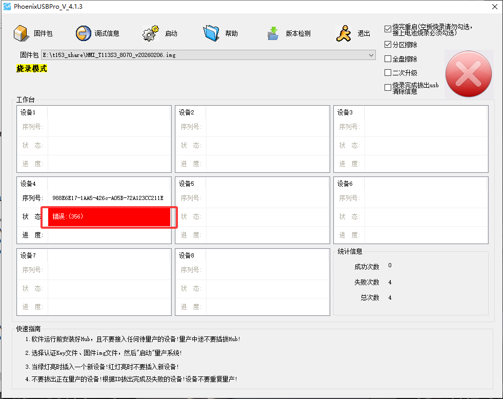

    t113-s3使用phoenixUSBPro烧录出现错误
    334
      Sunzp LV 3 最后由 编辑
      软件debug信息:
      00001141 14:07:13 [162592] [0227 14:07:13.0143|127608|E(0)|.\SDKClkdef.cpp|00219|OnBurnError]错误:(356)
      00001142 14:07:13 [162592] [0227 14:07:13.0145|127608|INFO|.\ProProcMan.cpp|03671|ProProcMan::OnToolsThreadMesage]MSG Callback Code: 0x20
      00001143 14:07:13 [162592] [0227 14:07:13.0145|127608|INFO|.\ProProcMan.cpp|03682|ProProcMan::OnToolsThreadMesage]free param...
      00001144 14:07:13 [162592] Closing image now!
      00001145 14:07:13 [162592] CloseImage OK
      00001146 14:07:13 [162592] unknown Tools command(96)
      00001147 14:07:13 [162592]
      00001148 14:07:13 [162592] INFO: ID=4, update failed
      00001149 14:07:13 [162592]
      00001150 14:07:13 [162592] [0227 14:07:13.0146|127608|E(0)|.\SDKClkdef.cpp|00219|OnBurnError]错误:(356)
      00001151 14:07:13 [162592] [0227 14:07:13.0147|127608|INFO|.\ProProcMan.cpp|03671|ProProcMan::OnToolsThreadMesage]MSG Callback Code: 0x20
