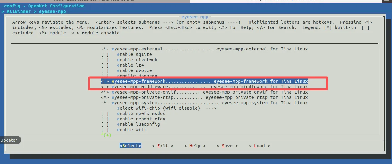

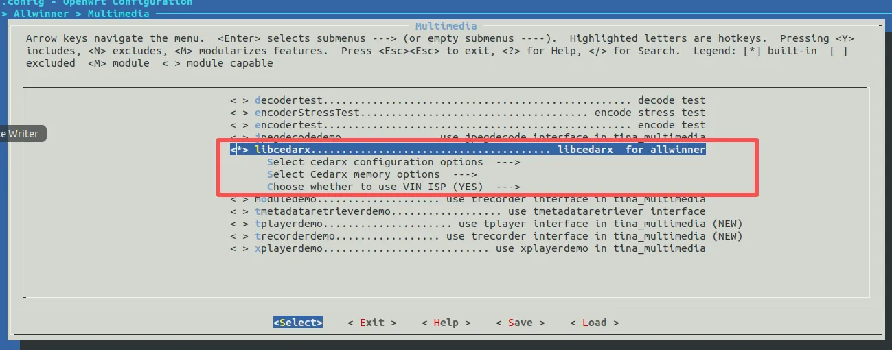

                                    你好,我在v851s的开发板是柚木,刚开始报错没有libAWIspApi.so,libAWIspApi.so libMemAdapter.so libvenc_base.so libcdc_base.so,后面解决了。现在报错是如上,请问这个错误是什么错误。能帮忙指导下吗,非常 谢谢
                                    menuconfig 同时打开libcedarx 和 eyesee-mpp-middleware 会编译sdk报错,说是libcedarx和eyesee-mpp-middleware 有冲突,编译的错误如下:
                                    Collected errors:
                                    • check_data_file_clashes: Package libcedarx wants to install file /home/ubuntu/tina-v853-docker/out/v851s/lizard/openwrt/build_dir/target/root-v851s-lizard/etc/cedarc.conf
                                      But that file is already provided by package * eyesee-mpp-middleware
                                    • opkg_install_cmd: Cannot install package libcedarx.
                                    • resolve_conffiles: Existing conffile /home/ubuntu/tina-v853-docker/out/v851s/lizard/openwrt/build_dir/target/root-v851s-lizard/etc/udev/udev.conf is different from the conffile in the new package. The new conffile will be placed at /home/ubuntu/tina-v853-docker/out/v851s/lizard/openwrt/build_dir/target/root-v851s-lizard/etc/udev/udev.conf-opkg.
                                      package/Makefile:66: recipe for target 'package/install' failed
                                      make[2]: *** [package/install] Error 255
                                      make[2]: Leaving directory '/home/ubuntu/tina-v853-docker/openwrt/openwrt'
                                      package/Makefile:111: recipe for target '/home/ubuntu/tina-v853-docker/openwrt/openwrt/staging_dir/target/stamp/.package_install' failed
                                      make[1]: *** [/home/ubuntu/tina-v853-docker/openwrt/openwrt/staging_dir/target/stamp/.package_install] Error 2
                                      make[1]: Leaving directory '/home/ubuntu/tina-v853-docker/openwrt/openwrt'
                                      /home/ubuntu/tina-v853-docker/openwrt/openwrt/include/toplevel.mk:236: recipe for target 'world' failed
                                      make: *** [world] Error 2
                                      make: Leaving directory '/home/ubuntu/tina-v853-docker/openwrt/openwrt'
                                      INFO: build_openwrt_rootfs failed
                                    所以我就关闭了eyesee-mpp-middleware。 如menuconfig

                                    请问是因为关闭了eyesee-mpp-middleware 的原因导致的吗?
                                    J 1 条回复 最后回复 回复 引用 分享 0
                                      jaying LV 5 @zhangsanxi 最后由 编辑
                                      @zhangsanxi 大概率是的,VencDequeueOutputBuf是#include "vencoder.h"
                                      #include "EncAdapter.h"里的,对应的libvenc_codec.so等等lib里的函数,没有走mpp-middleware的话,应该是不可以
                                      Z 1 条回复 最后回复 回复 引用 分享 0
