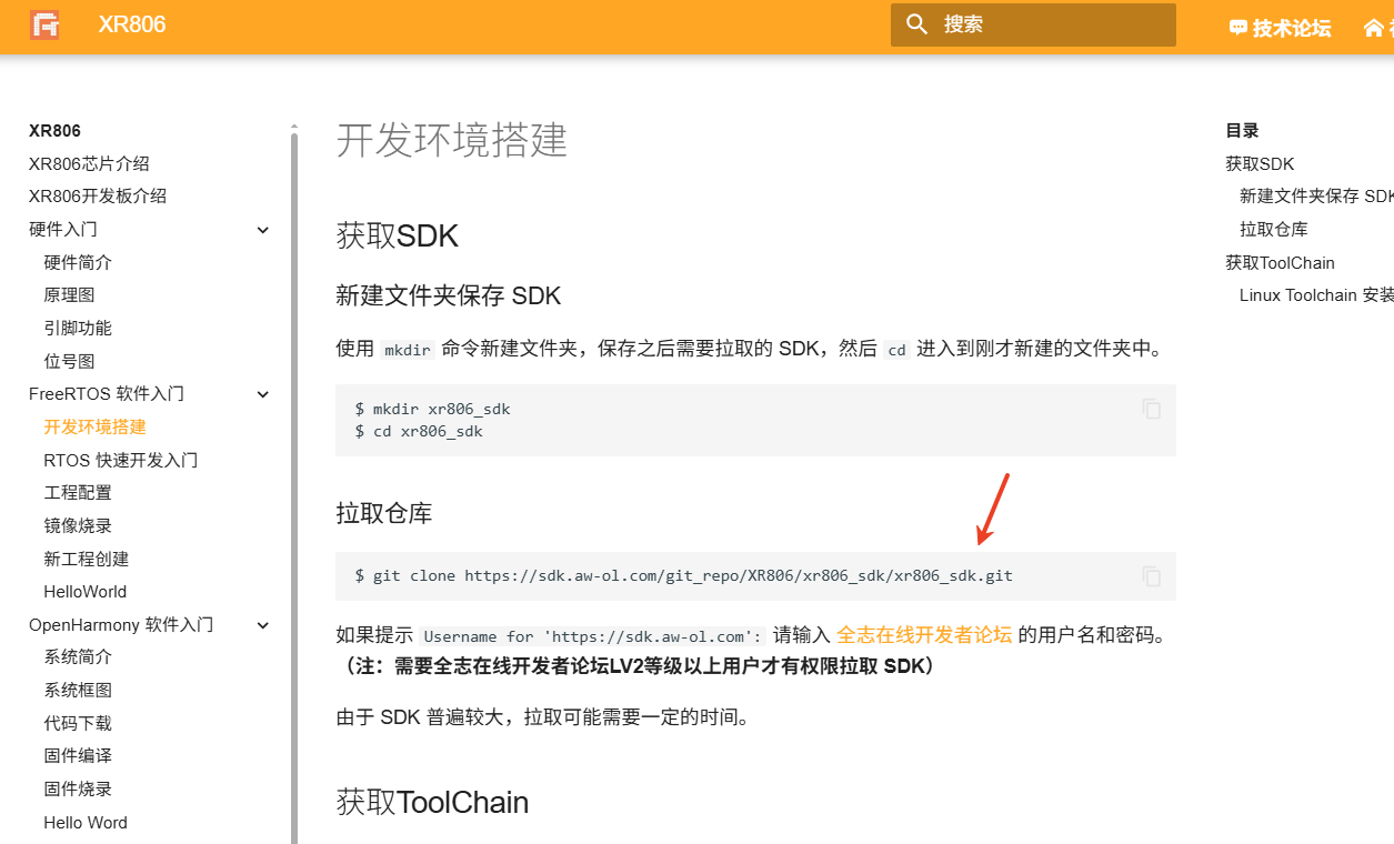

      (python27) ryan@pcvm:~/xr806_sdk$ ./repo/repo init -u https://sdk.aw-ol.com/git_repo/XR806/manifest.git -b master -m xr806_sdk.xml
      Username for 'https://sdk.aw-ol.com': bohotec
      Password for 'https://bohotec@sdk.aw-ol.com':
      fatal: repository 'https://sdk.aw-ol.com/git_repo/XR806/manifest.git/' not found
      fatal: cannot obtain manifest https://sdk.aw-ol.com/git_repo/XR806/manifest.git
      (python27) ryan@pcvm:~/xr806_sdk$ git clone ssh://bohotec@sdk.aw-ol.com/git_repo/XR806/xr806_sdk/xr806_sdk.git -b xr806_sdk
      Cloning into 'xr806_sdk'...
      fatal: '/git_repo/XR806/xr806_sdk/xr806_sdk.git' does not appear to be a git repository
      fatal: Could not read from remote repository.
      Please make sure you have the correct access rights
      and the repository exists.
      (python27) ryan@pcvm:~/xr806_sdk$ git clone https://sdk.aw-ol.com/git_repo/XR806/xr806_sdk/xr806_sdk.git -b xr806_sdk
      fatal: repository 'https://sdk.aw-ol.com/git_repo/XR806/xr806_sdk/xr806_sdk.git/' not found
        awwwwa LV 8 最后由 编辑
        xr806 使用 git clone,不是repo
        https://xr806.docs.aw-ol.com/rtos/env/

            bohotec LV 4 @awwwwa 最后由 编辑
