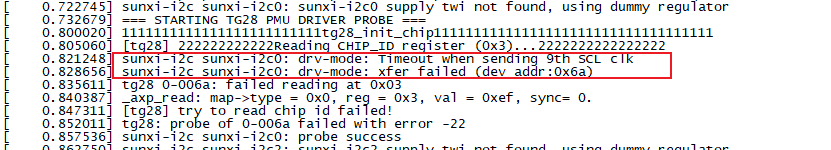

      T113S使用i2c接口连接外置RTC初始化失败,这个是什么原因
      [    4.429716] sunxi-i2c sunxi-i2c2: sunxi-i2c2 supply twi not found, using dummy regulator
       [    4.444395] sunxi-i2c sunxi-i2c2: drv-mode: Timeout when sending 9th SCL clk
      [    4.452364] sunxi-i2c sunxi-i2c2: drv-mode: xfer failed (dev addr:0x51)
      [    4.459795] rtc-pcf8563 2-0051: pcf8563_write_block_data: err=-22 addr=0e, data=03
      [    4.468327] rtc-pcf8563 2-0051: pcf8563_probe: write error
      [    4.474816] rtc-pcf8563: probe of 2-0051 failed with error -5
      [    4.481305] sunxi-i2c sunxi-i2c2: probe success
      [    4.488591] sunxi-i2c sunxi-i2c3: sunxi-i2c3 supply twi not found, using dummy regulator
      [    4.501228] sunxi-i2c sunxi-i2c3: probe success

        i2cdetect看看,记得loglevel=1

            @yuzukitsuru #
            `i2cdetect -y 2
                 0  1  2  3  4  5  6  7  8  9  a  b  c  d  e  f
            [14014.608115] sunxi-i2c sunxi-i2c2: drv-mode: Timeout when sending 9th SCL clk
            [14014.620277] sunxi-i2c sunxi-i2c2: drv-mode: xfer failed (dev addr:0x3)

                                        @y97788 !99dba5bb-6a90-441e-ab1a-c707fe2ab855-image.png 我的报错和你差不多,注释掉了也没有效果
